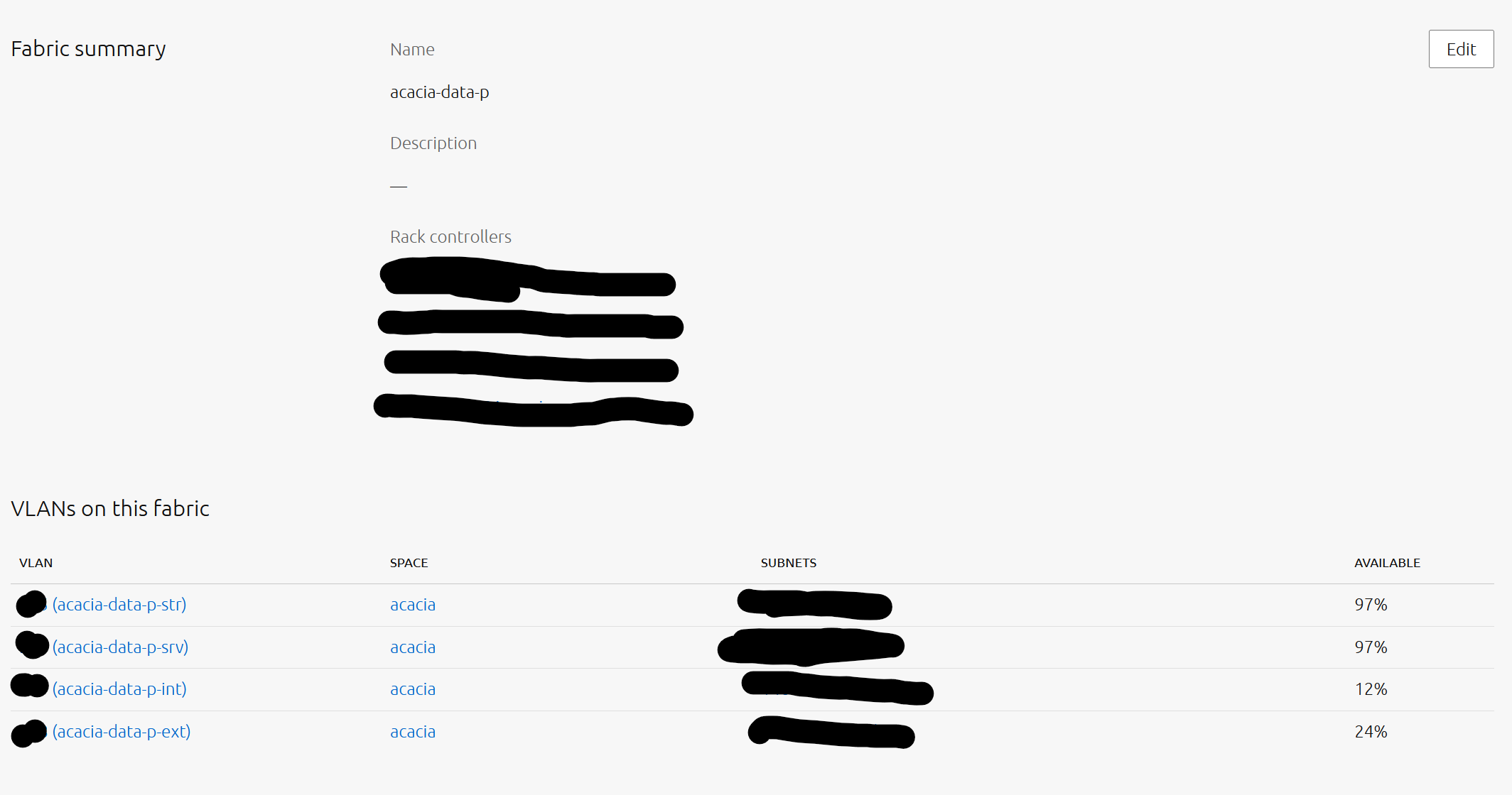

Fabric definition is from the UI this
When querying from the CLI though I cannot get the name of the last VLAN (that maas also reports as the primary VLAN, the first created I assume). It reports as Untagged, though the name in the web interface is there. See here:
maas $PROFILE fabrics read | jq “.[] | {name:.name, vlans:.vlans[] | {name:.name, id:.id, vid:.vid}}” --compact-output | grep astro-t
{“name”:“acacia-astro-t”,“vlans”:{“name”:“acacia-astro-t-int”,“id”:5312,“vid”:xxx}}
{“name”:“acacia-astro-t”,“vlans”:{“name”:“acacia-astro-t-srv”,“id”:5313,“vid”:xxx}}
{“name”:“acacia-astro-t”,“vlans”:{“name”:“acacia-astro-t-str”,“id”:5314,“vid”:xxx}}
{“name”:“acacia-astro-t”,“vlans”:{“name”:“untagged”,“id”:5311,“vid”:xxx}}

Maybe you have a caching proxy in front of MAAS that was caching the HTTP API responses? UI takes data from the Websocket API, but data comes from the same source.
Also count it be that you’ve queried the wrong fabric/VLAN? I see on the screenshot VLAN id:5315, but in the JSON output it is id:5311
