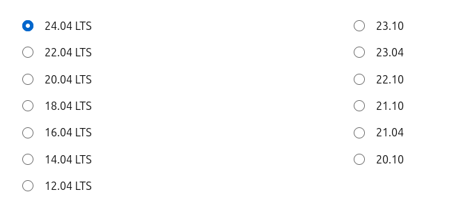

This is what I see
![Screenshot from 2024-05-09 08-51-37](https://discourse-maas-io-uploads.s3.us-east-1.amazonaws.com/original/2X/9/99732174c1171b0c06bf5dc13beba3e14f3b94d1.png)
What MAAS version are you using?
I’ve just updated to the MAAS snap (3.5.0-16308-g) and also see this as noble rather than 24.04 LTS. I run these in an offline environment and have imported the images per the procedures on the airgap image mirror page. Is this an issue with my importing or something with how this version processes that metadata?
