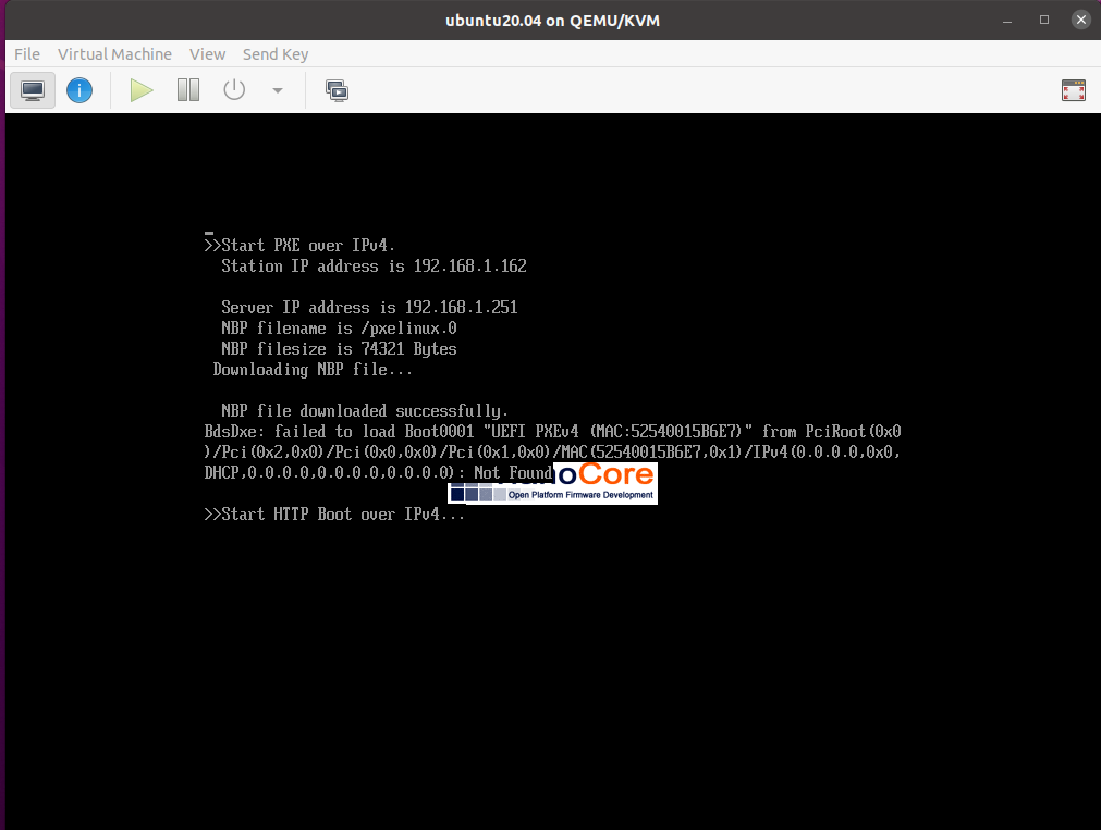

- The new hardware is not happy - PXEBoot works for enlist/comish but during deploy (at the final reboot) it bails when trying to boot local disk with “WARN: No MBR Magic, treating disk as raw”. I’ve seen this before and imagine it’s an EFI bios compatibility tweak, rather than anything related to the PXE changes in 2.9.

- I manually added a machine to MAAS, and now can’t delete it. in the UI I see this error.
