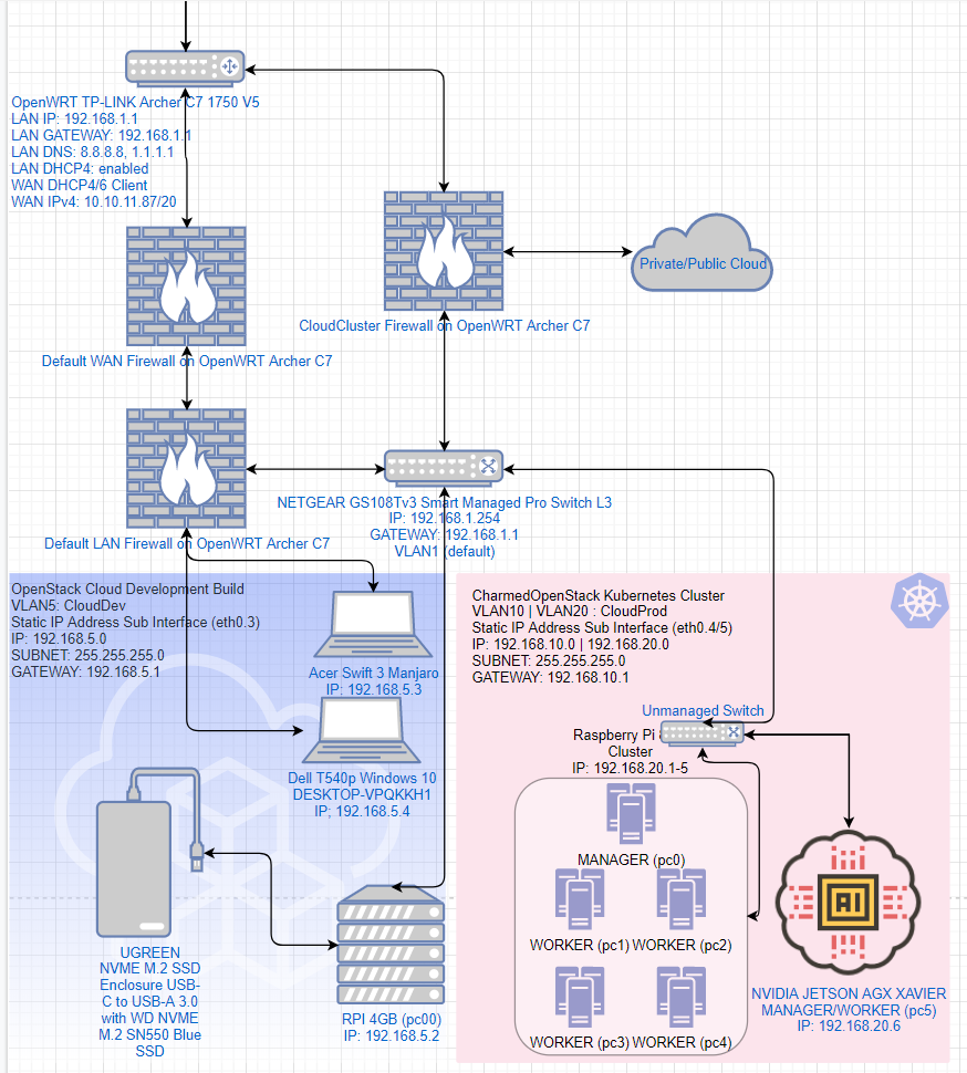

I have attached a Network Diagram
image of my homelab for further clarity. Although I am aware I could run all of this on a single host I am interested in learning about the actual production applications of HA clusters and High Performance Computing. I was planning to use my cluster of 5x RPi4Bs 8GB with SD cards and USB Enclosure SSDs as my production cluster. I have another 4GB RPI4 for development purposes and my home router is currently an OpenWRT flashed TP Link, as indicated in my Network Diagram. My original goal was to learn DevOps and iterate rapid deployments and changes to my Dev PI, then if all was working well, I would deploy the changes to my production cluster.I have followed this PXE RPI4 guide and tried to attempt UEFI legacy booting using my OpenWRT router as a TFTP server. I am not sure if this is the best approach but based on my end goals and current homelab setup I thought at the time of this project that this was the most feasible and easiest option to execute. But after attempting to deploy and execute I am being humbled by so many errors and challenges over the past few months.
