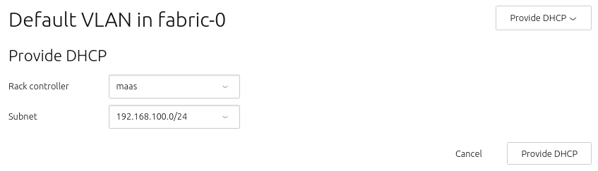

I am not sure if I did something special for the virtual bridge. Do you mean the bridge interface on the KVM host? If so - I am not sure I know how to do that.
I think all this was already done… The thing is - when I start the VM (or provision them through the POD) they do come up, they get installed, and then it is only after they get rebooted that they enter this state
