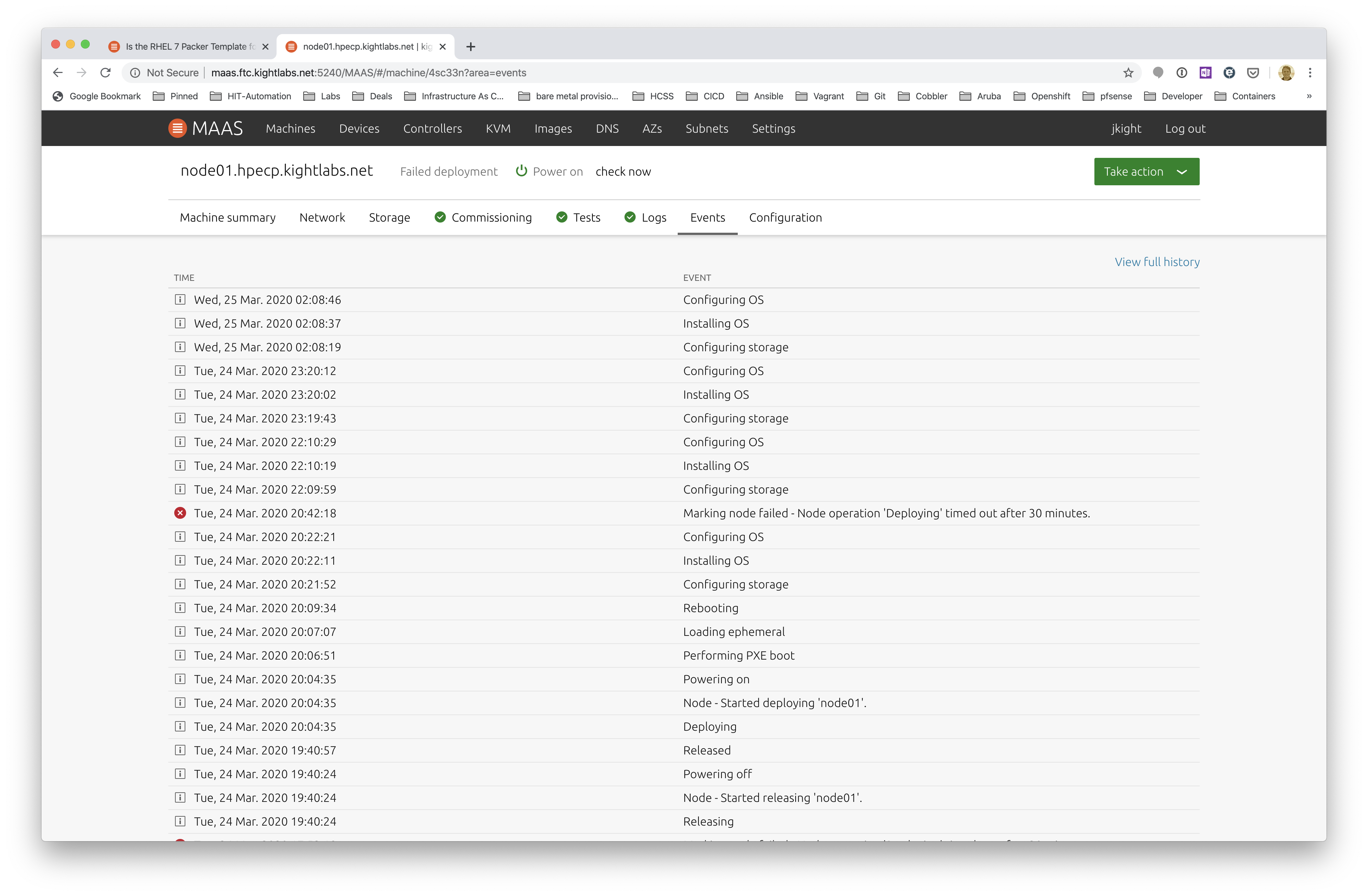

As a test, the only change that I made was to add a --proxy <proxy server> to the kickstart file on the cloud-init repo line.
I built the image with packer, then loaded it from the command line.
Deployed a physical server with a static ip – this failed.
Deployed a physical server with a maas domain and an assigned ip on the maas controlled dhcp network – this succeeded.
Deployed a physical server with a non-dhcp network, but an assigned ip… this failed.
Initial thoughts?
Pointers for troubleshooting?
Note, with the mass.io provided CentOS 7 image, I have no issues with statically assigned IP addresses.
I noticed that the MAAS provided CentOS7 image was based on 7.6.
So I built a RHEL7.6 image… same failures.
Ah, after additional testing, we appear to be failing for any servers that have VLAN tagging defined.
