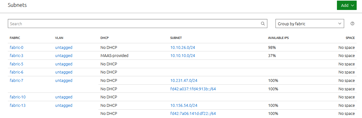

  1. Do you have DHCP enabled in MAAS? Can you make a screenshot of subnets tab?

Hi @troyanov
Please find the requested information below

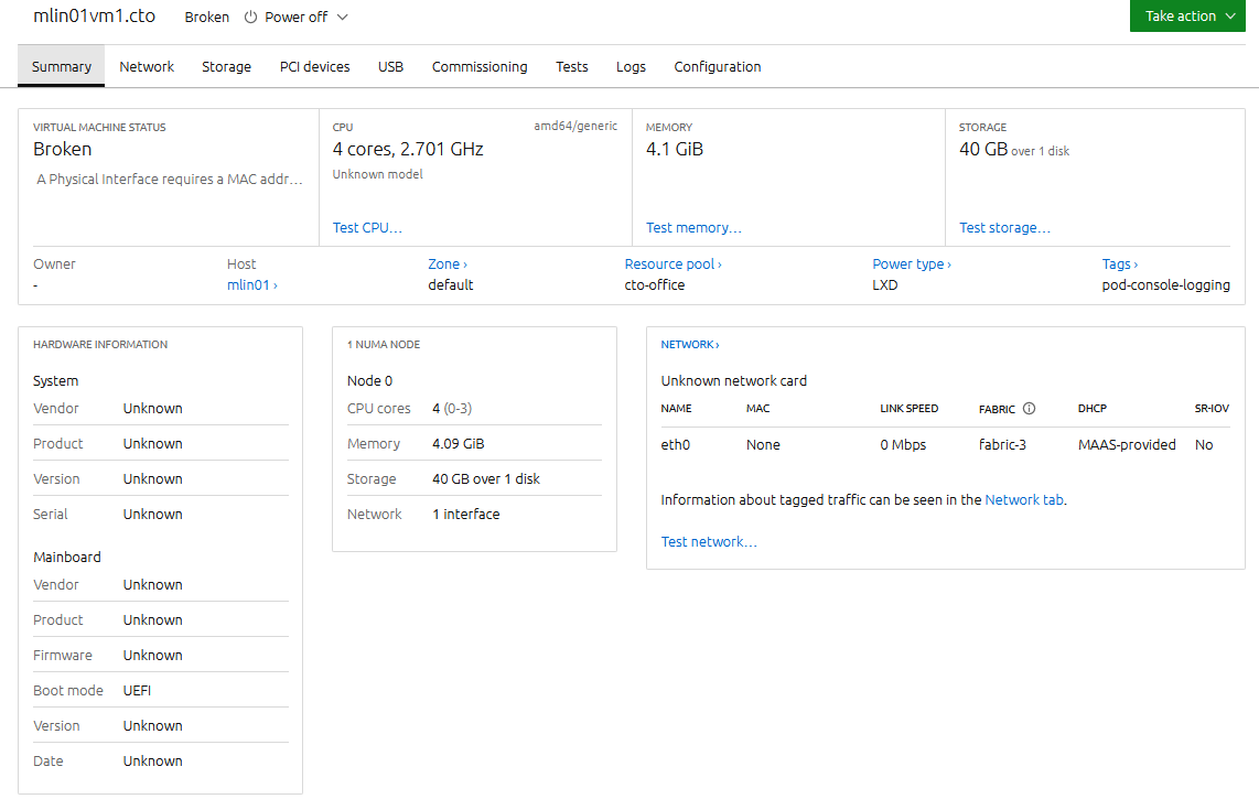

Now if I try to create new VM from MAAS UI it fails as shown below
This issue is present in ubuntu-core-22

Please find the replies to your first 2 questions
root@mlin01:/home/codingfreak# lxc ls --project maas-project
|   NAME    |  STATE  | IPV4 | IPV6 |      TYPE       | SNAPSHOTS |
| mlin01vm1 | STOPPED |      |      | VIRTUAL-MACHINE | 0         |
root@mlin01:/home/codingfreak# lxc start mlin01vm1 --console --project maas-project
Error: Failed to start device "eth0": All virtual functions on parent device "enp113s0f0" are already in use
Try `lxc info --show-log mlin01vm1` for more info

It seems that LXD fails to create machine with the parameters that MAAS is using for VM configuration.
What is the difference between machines (the one that is created by MAAS and the one that you lauch manually? lxc config $machine

Hi @troyanov
In a ubuntu-core-22 machine, I cannot start a VM in maas-project either manually or via MAAS UI
# lxc launch ubuntu:22.04 --vm mm02 --project maas-project
Creating mm02
Error: Failed instance creation: Failed creating instance record: Failed initialising instance: Failed getting root disk: No root device could be found
NOTE: maas-project is the lxd project created by MAAS UI
But I can start a VM successfully in default profile.
