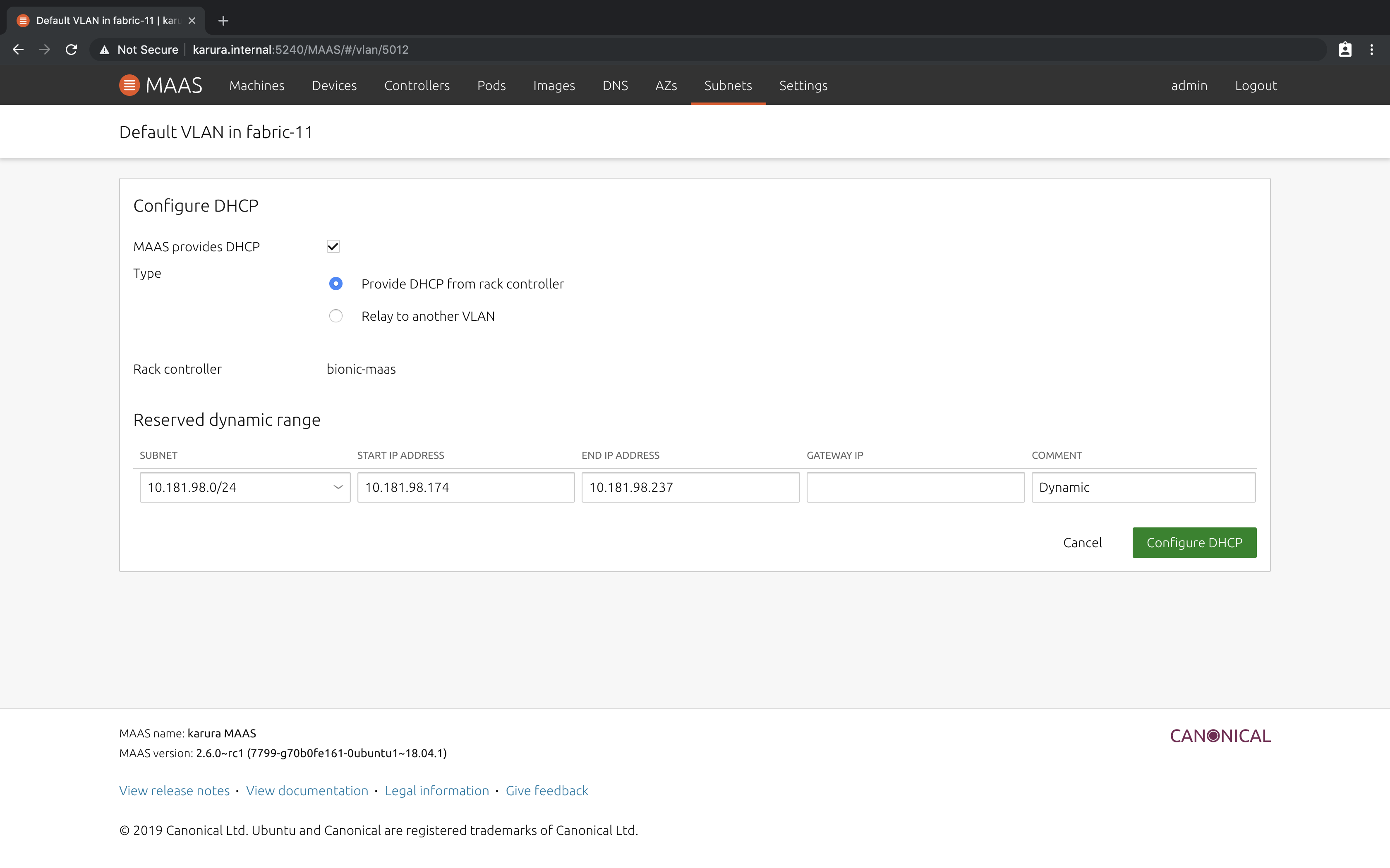

To enable MAAS-managed DHCP, under the ‘Subnets’ page select the desired VLAN and then:
  1. Under the ‘Take action’ button select ‘Provide DHCP’. A new window will appear.
  2. Select the primary rack controller. For DHCP HA, select both the primary and the secondary.
  3. Create a reserved, dynamic IP range. Fill in the fields ‘Dynamic range start IP’ and ‘Dynamic range end IP’.
  4. Apply your changes with the ‘Provide DHCP’ button.
Now, addresses in this range will get assigned to machines that are being either enlisted or commissioned. In addition, if you are deploying a machine that has an interface connected to the untagged VLAN, and it has an IP assignment mode set to ‘DHCP,’ then it will also get an address in this range.
